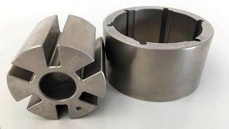

Part designation:
Rotor and stator for a hydraulic lamella pump (Ø40x32 / Ø56x32 mm)
Material:
Sintered steel
Industry:
Automobile supplier
Task formulation:
Deburring and honing of the sinter burrs
Brushes:
3x Tynex Ø250 interspersed with silicon carbide
Workpiece handling:
Transport belt and pull-down permanent magnet
Processing time:
90 seconds
Output:
325 pieces / hour
Processing is carried out as a continuous process. The grit is flushed out of the machine room.
