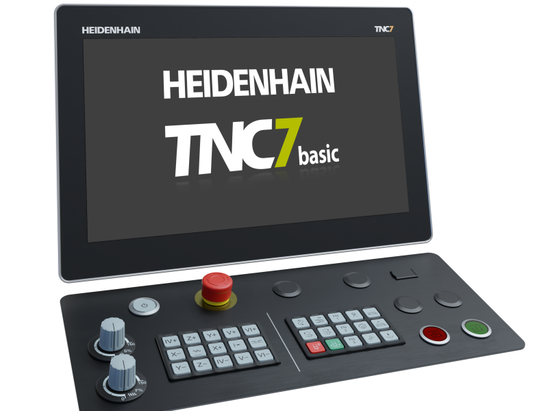

Thanks to its new hardware versions, spanning three different monitors (24-inch, 19-inch and 16-inch) and different keyboards, the intuitive TNC7 from HEIDENHAIN can be adapted to a wider range of applications. At the AMB 2024 trade show, HEIDENHAIN is focusing on the 16-inch version, called the TNC7 basic. As successor to the TNC 620, this new version lies toward the lower end of the TNC7 portfolio, delivering powerful TNC7 benefits to compact machines, such as those with 3+2 axes. Its typical TNC7 highlights include a monitor with Full HD resolution and access to an extensive suite of software options, such as MAS graphical 6D setup support, DCM collision monitoring and OCM trochoidal milling, all of which contribute to the control’s next-generation user-friendliness, efficiency and process reliability.
