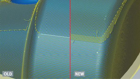

Smooth transitions
Machining marks are often visible at transitions between steep and flat areas, or at the extents of rest machining regions. The new ‘soft overlap’ function in hyperMILL® greatly reduces this effect. The milling tool is briefly lifted to blend the milling paths into one another. This prevents visible transitions from being created and results in better surface quality.
