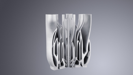

TRUMPF, the laser systems manufacturer and Industry 4.0 pioneer, is at the Formnext trade fair in Frankfurt to present its new 3D printers - TruPrint 3000 and TruPrint 5000. These medium format machines are based on laser metal fusion (LMF) technology, using lasers to generate complete parts layer by layer in a powder bed. These parts can measure up to 300 millimeters in diameter and 400 millimeters in height. With an ingenious tool change cylinder concept, which allows the construction chamber and supply cylinders to be switched out quickly, and an industry-ready periphery, these new machines are geared towards the large-scale production of complex metal parts. What's more, with the TruPrint 3000, TRUMPF is putting the spotlight on the complete process chain for additive manufacturing.

Both the TruPrint 3000 and TruPrint 5000 systems can be used to manufacture complex metal parts out of powder. Depending on the part in question, it may be made from any weldable material - such as various forms of steel, nickel-based alloys, titanium or aluminum - in powder form. Since the TruPrint 3000 is equipped with two supply cylinders, up to 75 liters of powder are available for each job, which is around two and a half times the construction volume - enough powder, in other words, to complete the entire manufacturing process without having to stop for refilling. And even if the powder were to run low, the ingenious tool change cylinder feature kicks in: the TruPrint 3000 is designed so that the supply and overflow cylinders can be changed out without interrupting the manufacturing process. This reduces downtimes while also increasing the 3D printer's productivity.
